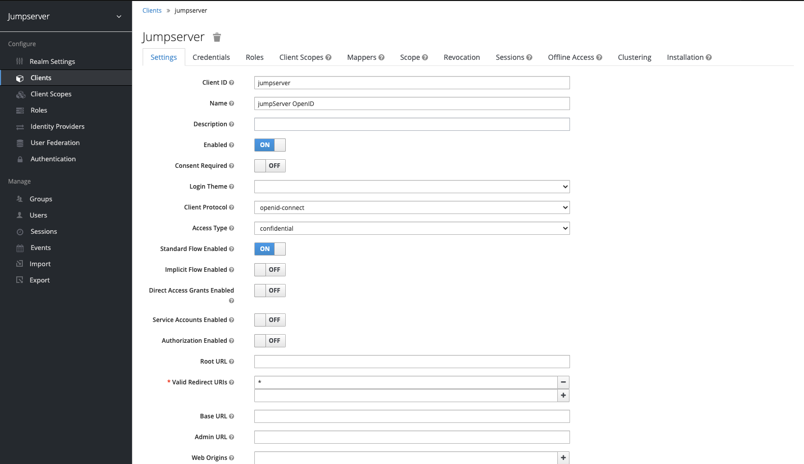

1.1 创建设置 KeyCloak Client

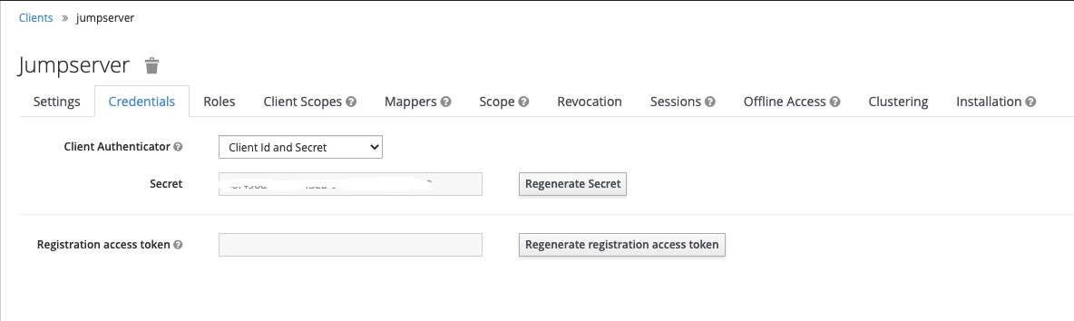

1.2 获取 Secret key

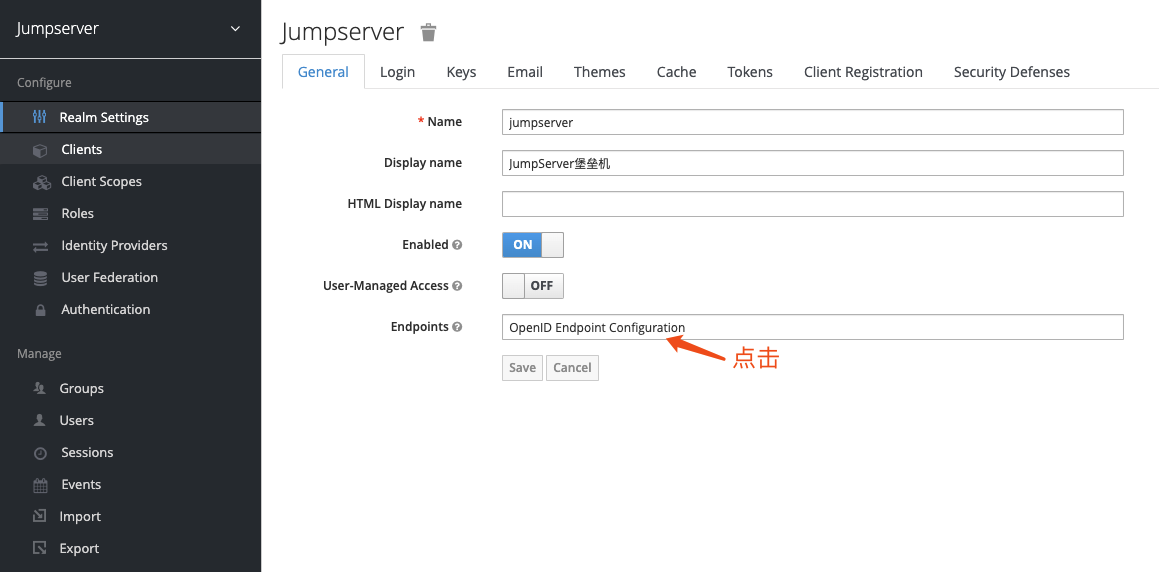

1.3 查看配置
"issuer":"https://id.jumpserver.org/auth/realms/jumpserver",
"authorization_endpoint":"https://id.jumpserver.org/auth/realms/jumpserver/protocol/openid-connect/auth",
"token_endpoint":"https://id.jumpserver.org/auth/realms/jumpserver/protocol/openid-connect/token",
"token_introspection_endpoint":"https://id.jumpserver.org/auth/realms/jumpserver/protocol/openid-connect/token/introspect",
"userinfo_endpoint":"https://id.jumpserver.org/auth/realms/jumpserver/protocol/openid-connect/userinfo",
"end_session_endpoint":"https://id.jumpserver.org/auth/realms/jumpserver/protocol/openid-connect/logout",
"jwks_uri":"https://id.jumpserver.org/auth/realms/jumpserver/protocol/openid-connect/certs",
"check_session_iframe":"https://id.jumpserver.org/auth/realms/jumpserver/protocol/openid-connect/login-status-iframe.html",
"grant_types_supported":[
"authorization_code",
"implicit",
"refresh_token",
"password",
"client_credentials"
"response_types_supported":[
"code",
"none",
"id_token",
"token",
"id_token token",
"code id_token",
"code token",
"code id_token token"
"subject_types_supported":[
"public",
"pairwise"
"id_token_signing_alg_values_supported":[
"ES384",
"RS384",
"HS256",
"HS512",
"ES256",
"RS256",
"HS384",
"ES512",
"RS512"
"userinfo_signing_alg_values_supported":[
"ES384",
"RS384",
"HS256",
"HS512",
"ES256",
"RS256",
"HS384",
"ES512",
"RS512",
"none"
"request_object_signing_alg_values_supported":[
"ES384",
"RS384",
"ES256",
"RS256",
"ES512",
"RS512",
"none"
"response_modes_supported":[
"query",
"fragment",
"form_post"
"registration_endpoint":"https://id.jumpserver.org/auth/realms/jumpserver/clients-registrations/openid-connect",
"token_endpoint_auth_methods_supported":[
"private_key_jwt",
"client_secret_basic",
"client_secret_post",
"client_secret_jwt"
"token_endpoint_auth_signing_alg_values_supported":[
"RS256"
"claims_supported":[
"sub",
"iss",
"auth_time",
"name",
"given_name",
"family_name",
"preferred_username",
"email"
"claim_types_supported":[
"normal"
"claims_parameter_supported":false,
"scopes_supported":[
"openid",
"address",
"email",
"offline_access",
"phone",
"profile",
"roles",
"web-origins"
"request_parameter_supported":true,
"request_uri_parameter_supported":true,
"code_challenge_methods_supported":[
"plain",
"S256"
"tls_client_certificate_bound_access_tokens":true,
"introspection_endpoint":"https://id.jumpserver.org/auth/realms/jumpserver/protocol/openid-connect/token/introspect"
